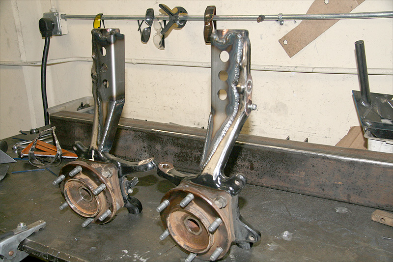

    Interesting but I don't know how much additional strength you would get with these puppies - they look like they would just load the forces into that bend area!
    The Blue Room post said that Demello installed these "TC" gussets. I guess they cut em and welded them up!

  20. #20
    Name
    Andrew
    Join Date
    Jun 2010
    Location
    San Antonio, TX
    Age
    28
    Posts
    4,455
    You mean the area that's bolted to the upper ball joint? I don't see a problem with that
