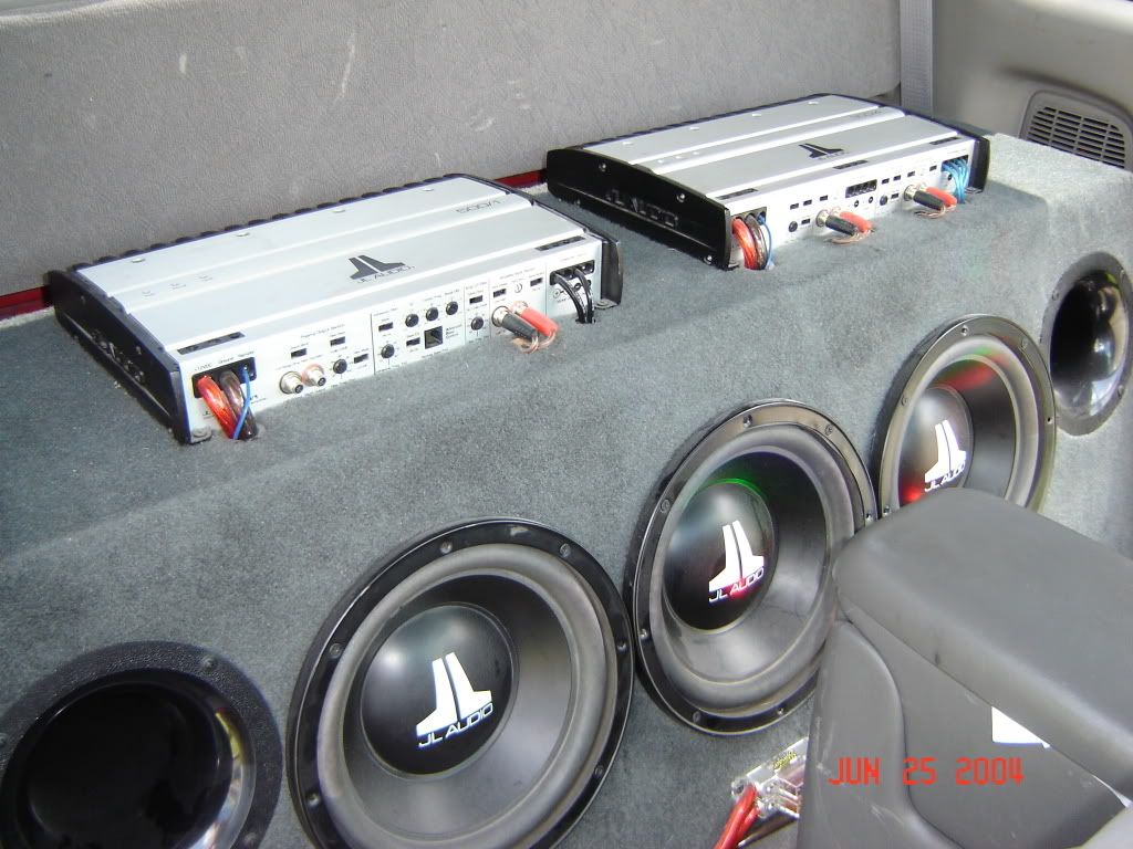

    Are the shallow ones the way to go? dont really know how much depth I have to work with. My system in my 02 took up the whole access cab. It wasnt comfy back there anyways.
    Here are some pics of it

    If you want to keep it stealth (no box on the seat) then you are limited to about 5.5" of mounting depth. Larger diameter magnets will effect that number. I had some 10" Image Dynamic ID10's behind there and I had to have the box made with an extended mounting depth, basically they cheaped out and used thinner material where the magnet goes. A good shallow mount sub is pretty impressive. I head over to your local JL dealer and see if you can listen to something they installed a 13W5 in. It will fit back there. I'd also give Mr Marv a call an see about having him build you a box. But I wouldn't try to fit 8's under the rear seat. Good gimmick and if I owned a car stereo shop I might do it just to show people it can be done.. but not in my personal ride. A sealed 12 with a good amp that can control it and make it hit is the way to go IMO.
    I love that 02.. I wanted a access cab with the 'stepside" bed. Somebody at my bank has a silver TRD 4x4 version just like that.
