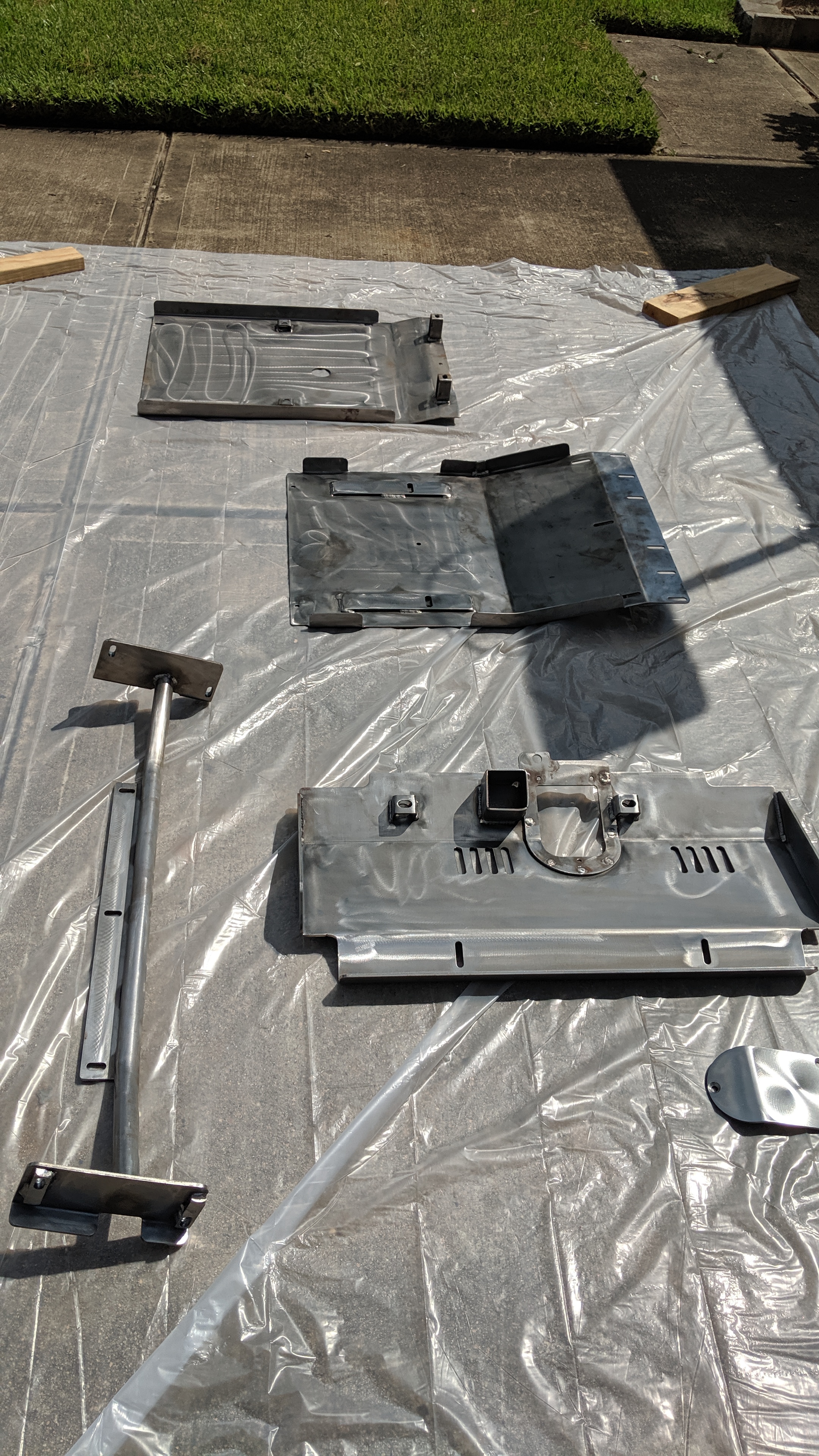

Almost didn't want to paint these, the steel looks so nice. They're painted and ready to install on the next oil change. Went with a 3 piece "overland protection", lite steel (1/8") for the trans and mid skids. Front is the regular thickness of 3/16". I'm not happy with the RCI aluminum ones. I'll post some comparison pics once these are our on.
Who makes those? Are the RCI on the Taco?
I thought I remembered you bought the aluminum ones for the 4R. Can't go wrong with BB.
Well.. don't leave us hanging.. use more words. :) What suspension did you order?
Looking forward to the comparison review of the new 1/8" skids that replaced the aluminum ones.
Man, Myth, Legend
Not much to report on the suspension, pretty standard lift per my reading. Bilstein 6112 front (1.6"), Wheelers rear coils (1.5"), Bilstein 5160 rear, Wheelers superbumps front and back. Hoping to not need UCAs.
Those steel skid plates already look better. Little disappointed on the install. One of the holes up front didn't line up proper. Wasn't terrible to remedy, but still. The Budbuilt plates provide much better protection to the front LCA cam bolts than the RCI ones did. Haven't yet had to change the oil with these plates, but that's coming up next month I project.
Can't go wrong w/the superbumps over OE. Big difference if you go in too hot from time to time. Good luck on the alignment #'s
I don't know anyone who's been able to just bolt up good skids, but I'd be sure to give them constructive feedback. For some reason a bolt hole missing or being off is always part of the fun. If a company could get their stuff strait and efficient you'd think they could make a killing. I'd bet a marble countertop guy could 3d model the bolt points and figure out basic skids in a hr or two with his 3d maping tools. My skids from the og ATO were missing a hole in one and his cross-member was designed to be right where the exhaust flange was so it rattled. His "mock up" was on his custom exhausted Tac or so he said when I inquired on the design modifications I suggested after my install

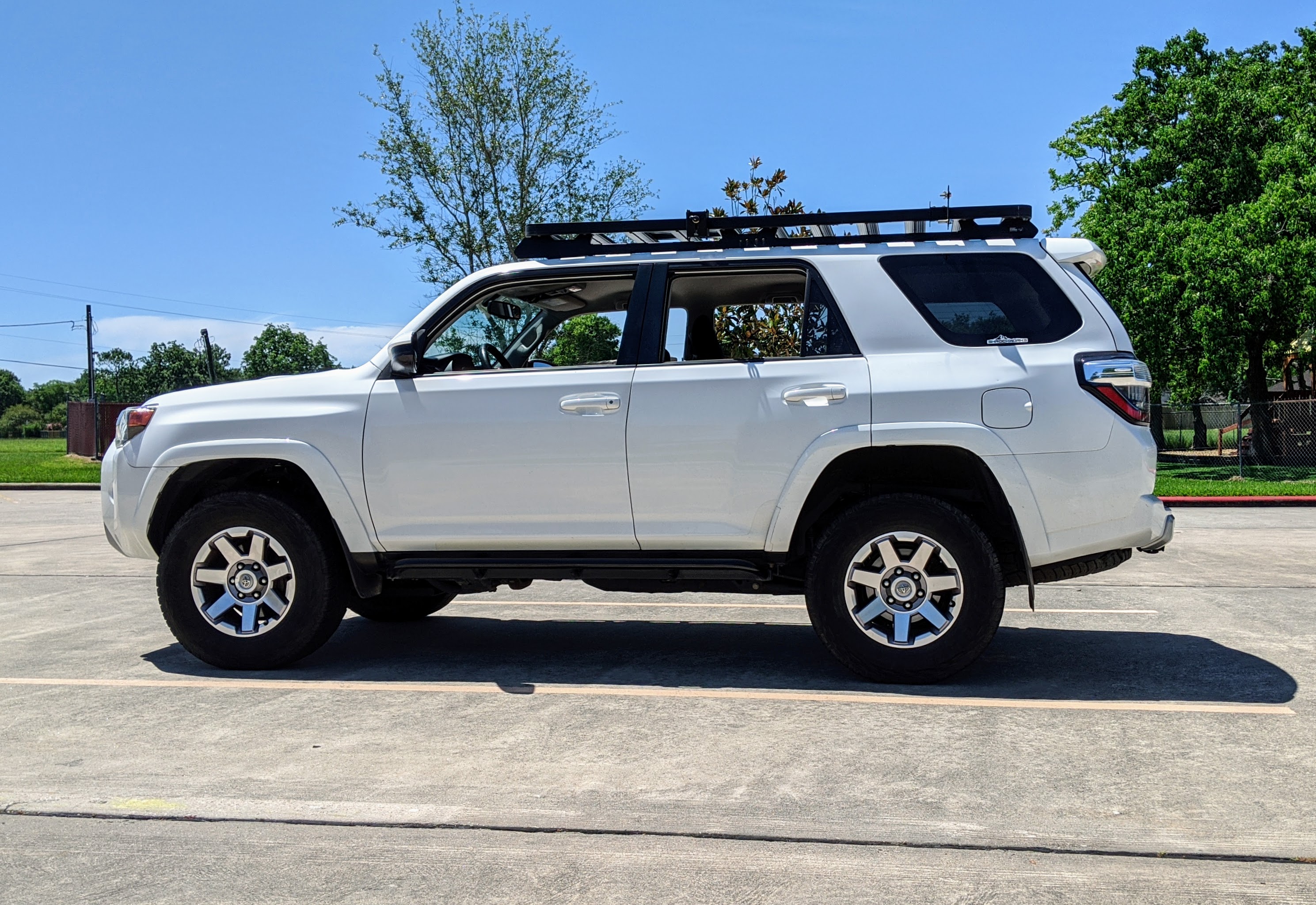

Finished up the lift this morning. 1.6" up front 1" in rear. Rides a lot better. I never liked the stock suspension, too soft and squishy feeling. Will get an alignment Monday and will be all set.
