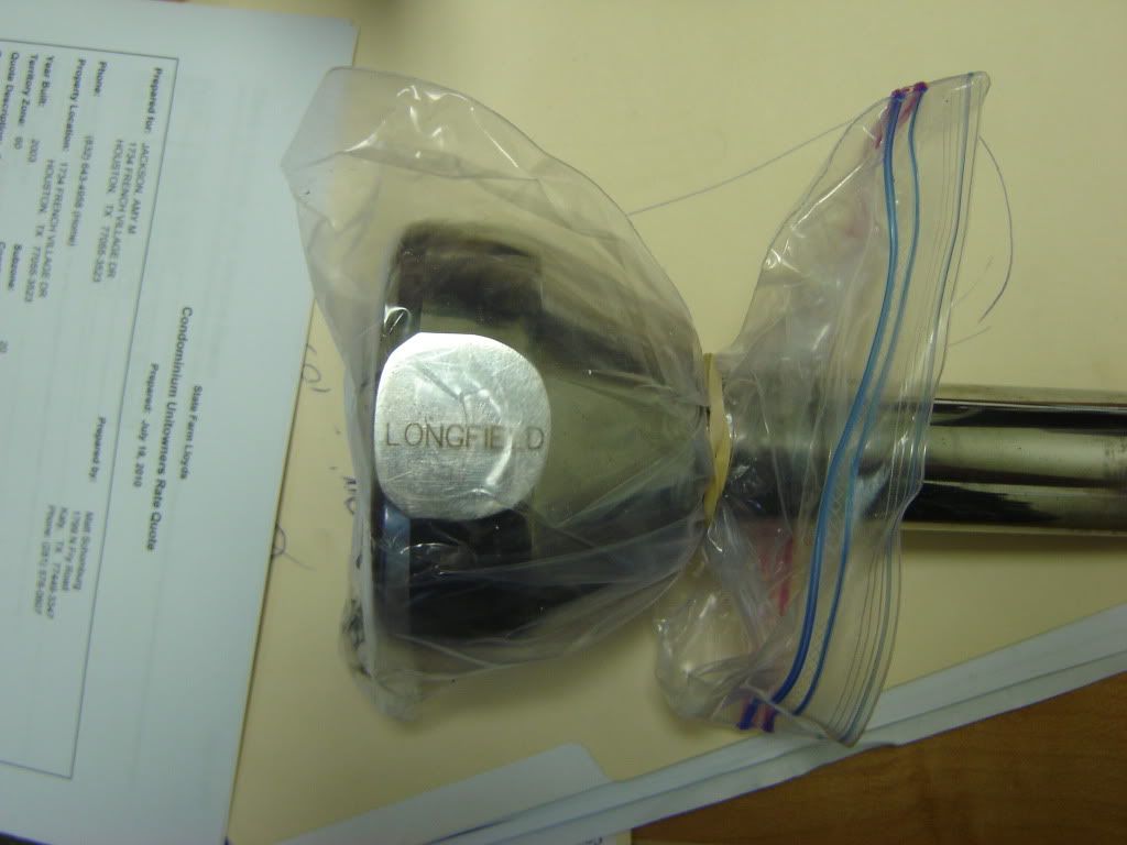

    Picked up a set of Longfield 30 Spline axle shafts :cool:
