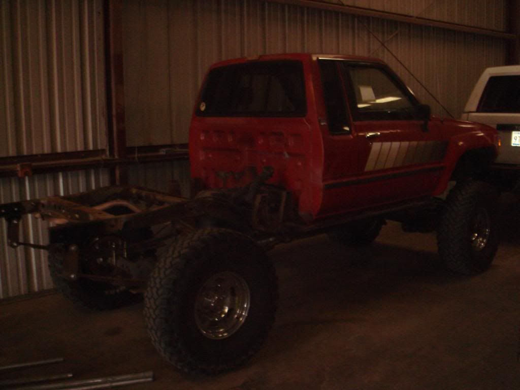

PICS finally
I only got a couple. The wheelbase is sitting at 113" right now. Front has been burned in and pushed forward about 3.5" over stock. Approach angle is looking really nice. The overloads on the 63's are going to have to be trimmed down a little but other than that the rear is done

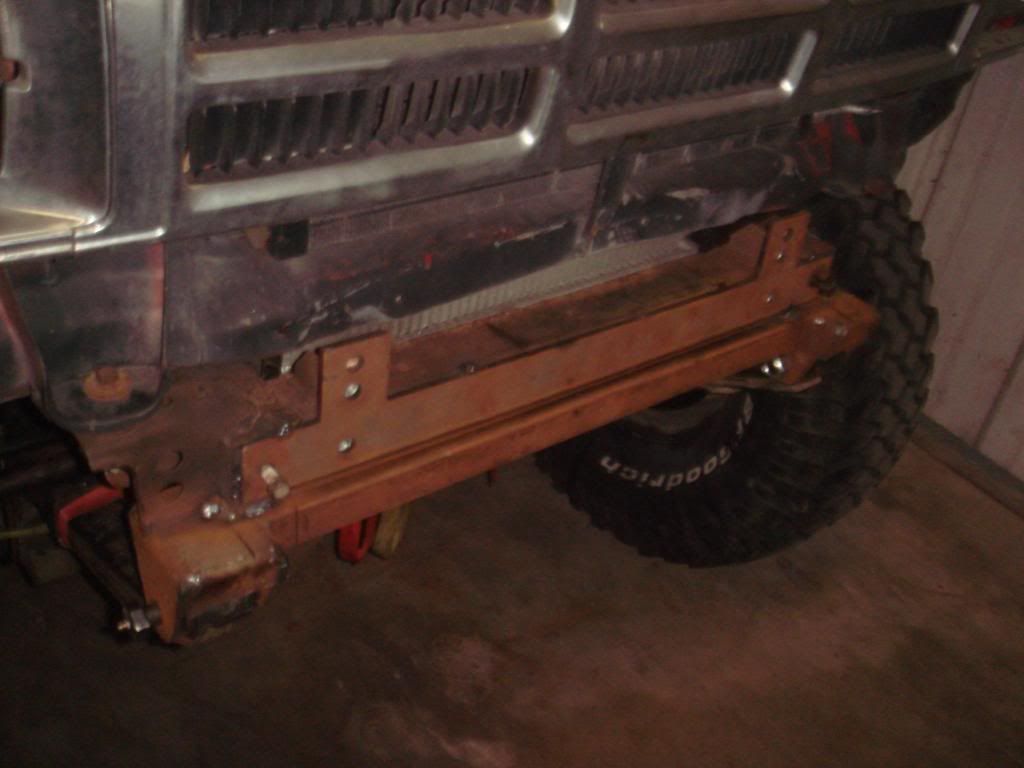

Here is a close up of the front stretch. I like it a lot. The front is about 1/2" high and will settle out with the bumper and winch installed

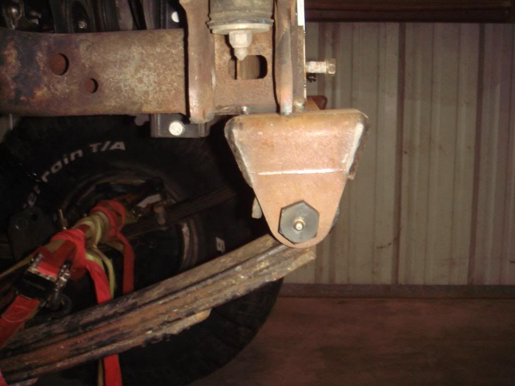

Front hanger pushed forward
Front
