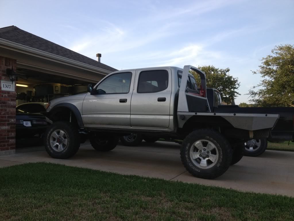

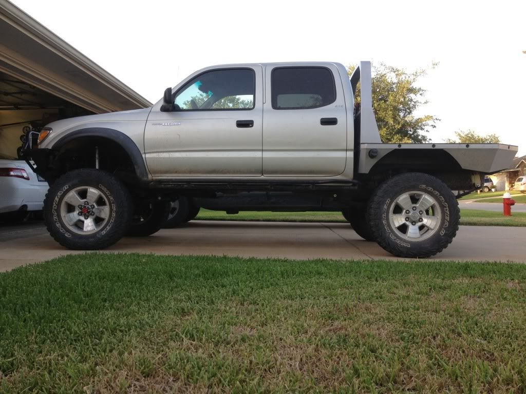

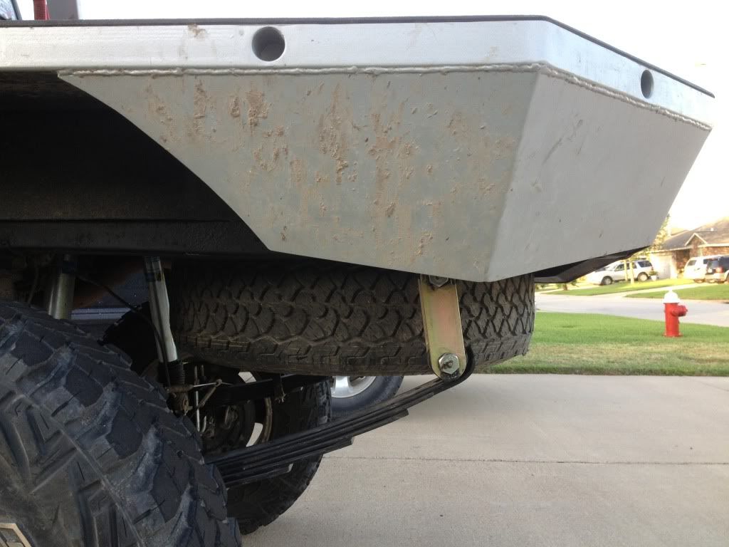

shackle angle how it sits right now
and a few random shots sitting in the driveway. Frame height is 24".
Ride height looks good I'd leave it alone unless it doesn't perform well

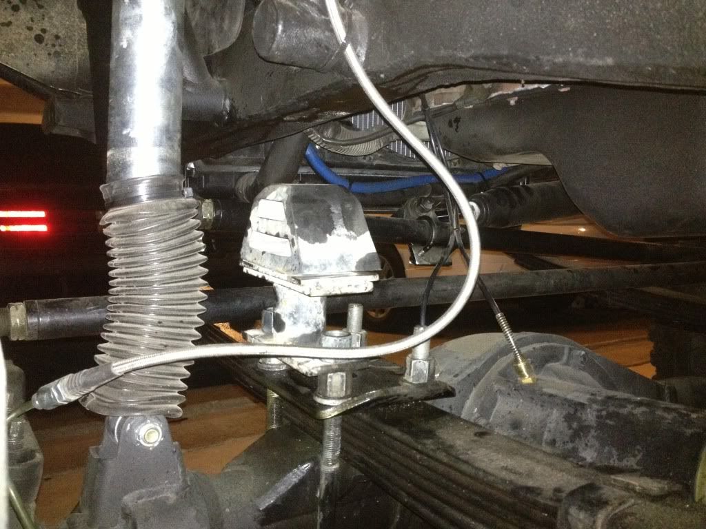

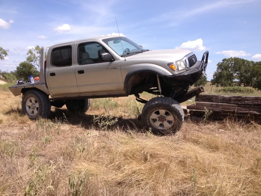

Got the bump stops set up for the front and added a leaf back in on both sides.

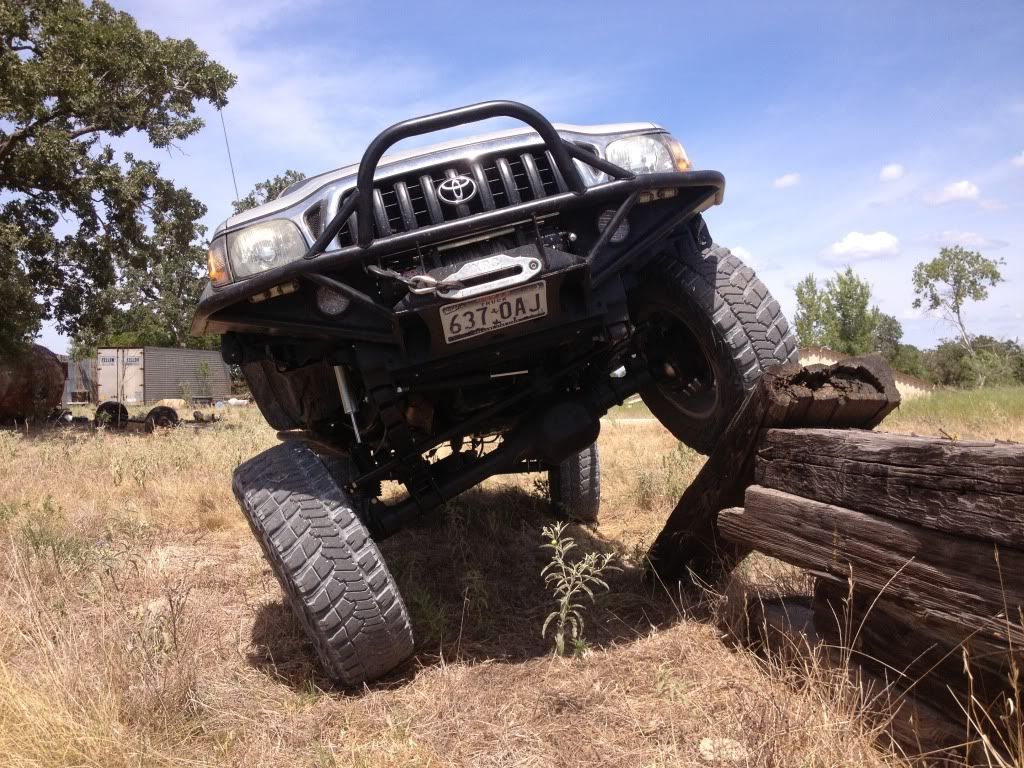

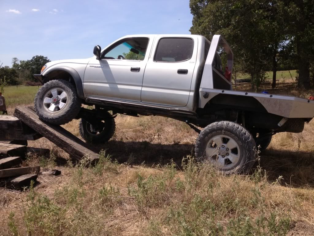

After getting the bump stops and springs in I tested out travel/flex:
Very nice.
