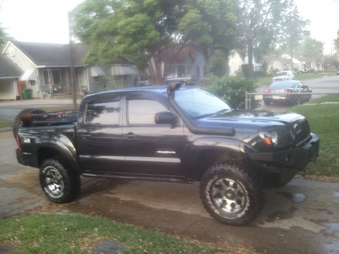

I didn't have to trim anything off the inner fender or snorkel, other than the piece that was designed to be trimmed. I just used the bolt studs to actually mark on blue tape where I should cut. Similar to your wax trick. As for the elongating of the holes, its not a big deal, those huge washers will hold it in place. As long as your holes aren't too big. LOL.

Yea, those washers are huge. Hows the alignment with your antenna mount? Your pic looks just like everyones since I did mine. Slightly down sloped like the stock intake. Josh used most of his stock intake.
its perfect.. I don't have any pics though.

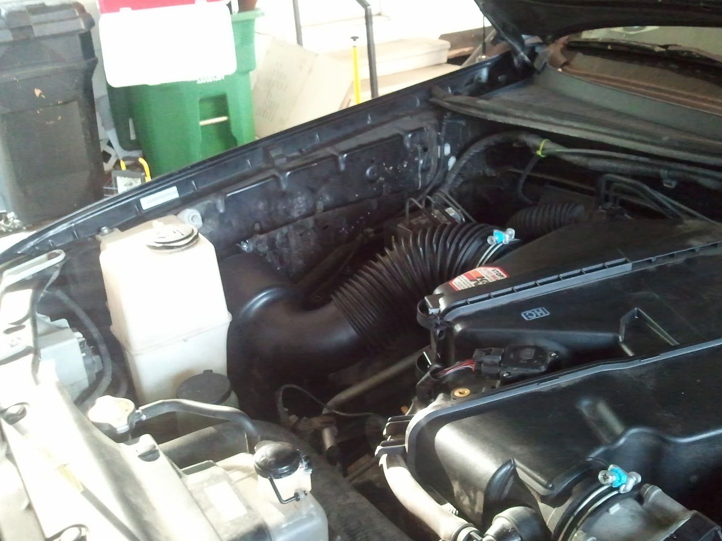

I can't wait to take mine off when I do my spark plugs. Thinking the structural silicone will be fun with the rigid exhaust pipe. This time Ill also remember to spray the heat wrap with some black sealer so it stops throwing fibers all over my engine bay.

Hows the bend in your rubber tube? My antenna location is spot on and I didn't trim the snorkel so that's why I think I had to cut the inner fender forward. The bend in rubber tube bottomed out on the snorkel and was kinking it a little. The same was true with everyone elses, so we started trimming the snorkel itself. If it's kinked a little it could be restricting you from getting the full advantage.?.
Its been a while since I installed mine.. but IIRC its not bad.. not a real tight kink or anything. I might take a look at it. I suppose it wouldn't hurt to take it off and make sure no rust is forming back there.

Looks great Rich, I like how you did it under the hood. Is that the stock piece?
