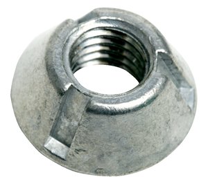

If I do anything on the ass end of the taco... this will be the route I will take - I like bedspace and being able to overload my truck!![]()
true.. more heat as well.
Yeah, but you could probably line up 4 coilovers side by side
Just ordered a bunch of these to 'lock' my lights to the truck. Figure its a deterrent. Damn socket to install them is not cheap though!
The only thing that might make it tough on the tacoma is that you don't have as much clearance between the tire and the frame as I did. But since the stock lower mounts are further in, I would think moving them out wouldn't be a problem.
Also, you could notch out the stock top mount and weld in some tabs like I did on my front suspension. You'll have more room to get pretty welds than I did![]()
gonna attempt to redjust my ARB bumper today if i get the motivation and lock it in place.
also installing a Cobra CB in my buddies truck
Put a hitch on so I can have a rear recovery point now. Got it on sale for 50% off, or else I would have done a bumper :o
gonna attempt to redjust my ARB bumper today if i get the motivation and lock it in place.
also installing a Cobra CB in my buddies truck
How do you plan on Locking it? My last "Lock Job" involved a welder!![]()
