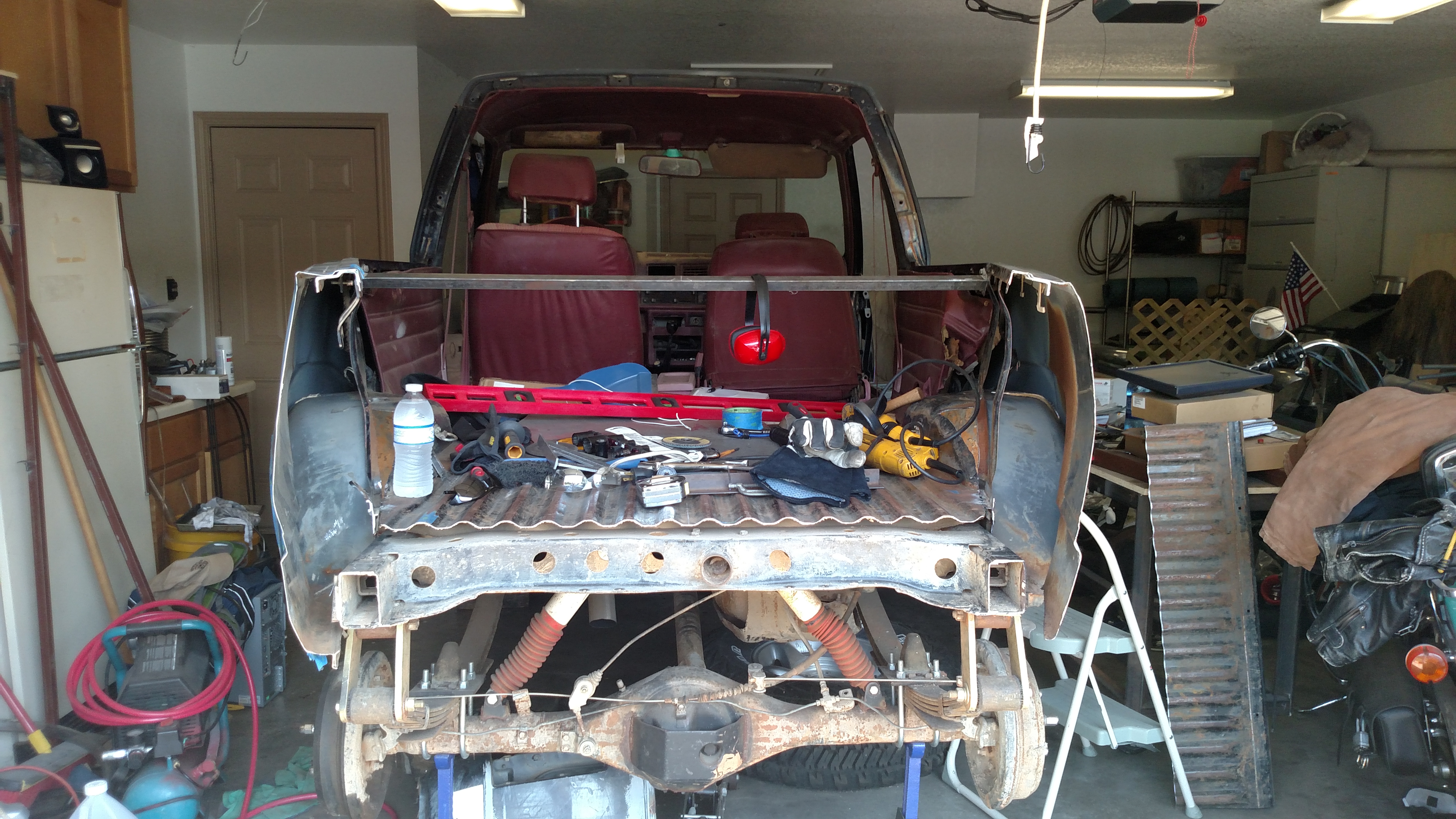

Making solid progress this morning. The sides are dovetailed in 13* and at the back fender brace 21" off center of the bed. Setting up the measurements and ensuring them all took some time but will be worth it in the end. Measure twice, mark once, forget number I was marking, measure again, mark, cut. Repeat.
Looks good man!

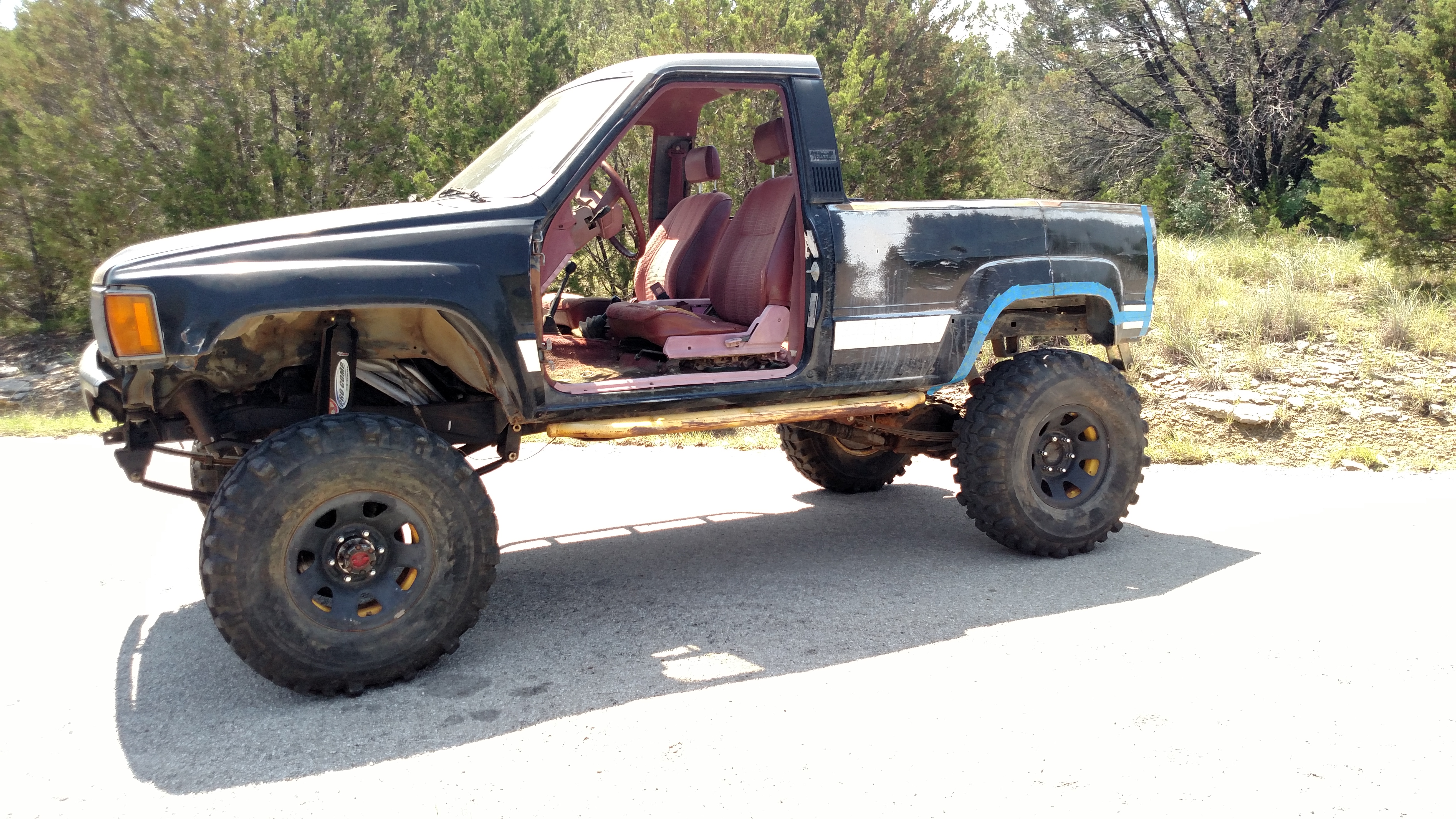

Thanks; it is nice to have this big chunk knocked down. The rest of it is back to smaller detail work that is easier to work on IMO. I took it out for a spin around the neighborhood and the motor was still sucking. It acts like it is running either super rich or the spark is failing until it catches up in RPM and then it runs okay. It still has significant throttle response lag when under load.
Check your air inlet tube. Mine was cracked on the bottom (not obvious to see) and it was running like shit.. would not idle. Fixed the hole and bamm.. ran like a top. Todd and Rob found the issue for me at Long Ranch as I was not seeing it.
