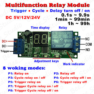

My Kenwood wanted you to set the parking brake to be able to watch movies and stuff. But turns out that it simply wants a ground.. so attach it to ground instead of the parking brake and problem solved.
Yeah this one is a little more complicated. Probably so you can't do exactly what you said. But someone still built a workaround for it. This one you have to push the parking brake, release it, and then push it again and then it unlocks. But the bypass module was only like $13 I think so not bad at all.
You can just do that with a little switch mounted to ground and manually toggle it when you start the truck. Or something similar with a time delay relay like this.
Or I can just wire in the little bypass module lol
sure, for a few more bucks anything is possible.
