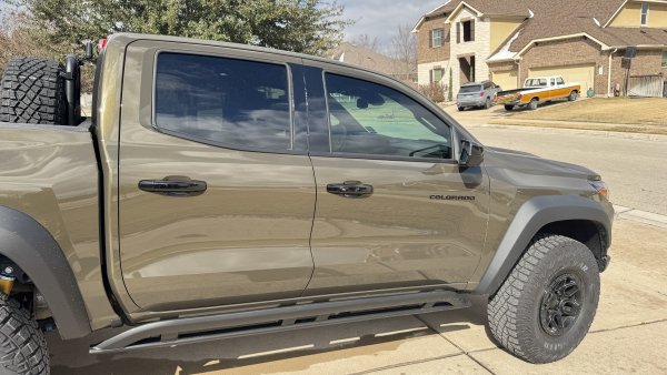

I bought some 2k gloss black spray along with the clear coat. Plan is to paint the B pillars on the Colorado gloss black. I did then with a cheap black vinyl wrap job and I liked the look, I just did a shitty job on the wrap. So hopefully this paint turns out nice. Just need to prep for it carefully.
Some pics of when I did the vinyl wrap.
Before
After
