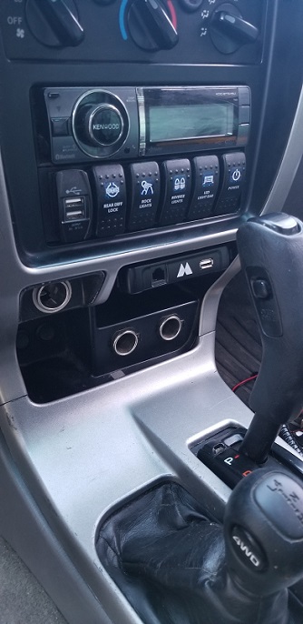

Midland MX275 is mounted up; just have to do the power and antenna cables tomorrow. I also did some sound deadening work while I had the center console and some dash pieces apart.
