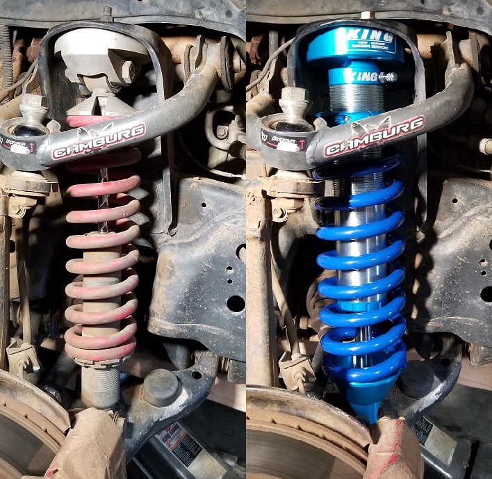

Back and front shocks are all on now. The test drive went really well and tomorrow morning it is getting an alignment.
Old ToyTecs and the New Kings
Enjoy the pic - they will not be this clean long.
Nice!

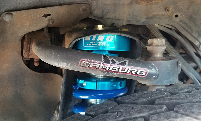

Only "King" tip I can provide you may already know and have done but put the bottom coil adapter's slotted "hole" for the shaft facing rearward/lowest point. Will help it drain foreign objects and wet stuff.
Nice man! Is it level?

It should be free spinning and held in place by coil tension. once you relieve coil tension its got the slot so you can pull it out and remove the coil w/o having to pull off the top hat.
just took a pic of mine for ya
not a big deal either way, but over time I like my stuff to drain vs build up

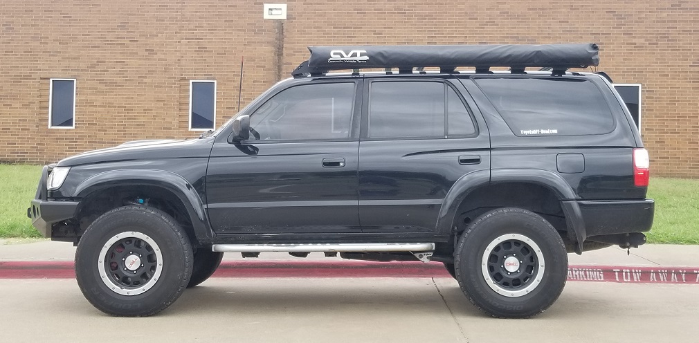

How the 4Runner is sitting today. Apparently it is lifted right at 2" in the front and 3" in the back over stock. I will see how it settles in the coming months though. I also picked 17" TRD rims from @RichardB23 yesterday. It will be later this year before I put them on though.
Looking good! Which rims did you get? Are you swapping out the faux locks for them?
